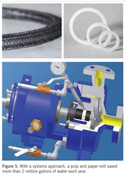

Pulp & paper
A pulp and paper plant experienced excess water leakage from a paper machine pump moving brown stock. The leakage to drain through the packing was 4.23 gallons per minute. This amounted to 2,102,400 gallons per year.
Water loss to the process (causing dilution) was 1.5 gallons per minute. The yearly amount was 262,448 gallons per year. The total water lost because of poor packing function was 2,628,000 gallons each year.
A systems approach (see Figure 5) helped solve the excess leakage problem. The system included:
  • mandrel-cut, high-performance braided carbon packing; temperatures to 1250 °F, shaft speeds to 4,000 feet per minute
  • 1-inch, high-performance, thermoplastic lantern ring
  • schematic FA12579A environmental controls properly set up.
The system eliminated the leakage to drain, saving 2,102,400 gallons per year. The water into the process was decreased to 0.5 gallons per minute, saving 262,448 gallons per year. The total savings for the plant were 2,364,448 gallons each year.
