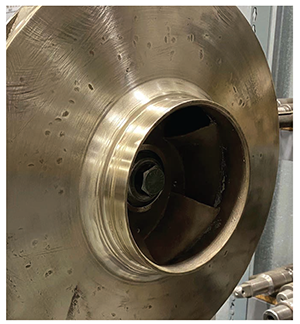

Simply put, cavitation is the rapid formation and collapse of vapor bubbles within a liquid (see Figure 1).
Figure 1. Mild cavitation can be seen at this impeller’s inlet area. Image courtesy of Motion.
As a liquid passes through a static pressure—which is lower than the liquid-vapor pressure—bubbles are formed. These bubbles can be up to 50,000 times larger than the original liquid size. As the bubbles move back to a static pressure higher than their liquid’s vapor pressure, they rapidly collapse or implode back to a liquid state.
This rapid collapse takes just a microsecond to happen, and the implosion creates a microjet and a shock wave during the collapse. If this implosion happens near a metal’s surface, the shock wave can loosen or damage the metal. Debris can then be washed away; this is called internal cavitation.
If these implosions and cavitation are allowed to continue, there will be additional loose areas and more metal loss. This can form pitting in the metal, or in some cases, it can resemble cheese with complete surfaces damaged.

In most cases, you can hear it. Listen for the sound of rocks or marbles inside the pump’s casing; it may help to use a stethoscope. Once you hear and identify cavitation, you will remember it. You can also see cavitation damage to your pump’s internal surfaces. In many cases, pitting can be seen on the impeller either at its eye (suction cavitation) or its tips (discharge cavitation).
