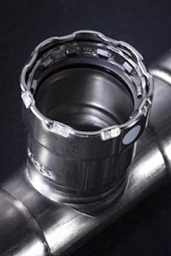

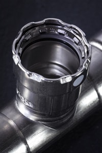

For manufacturing facilities, the introduction of Viega MegaPress Stainless press fittings will reduce the time required to make pipe repairs compared to other pipe joining systems.
For manufacturing facilities, the introduction of Viega MegaPressStainless press fittings will reduce the time required to make pipe repairs compared to other pipe joining systems. Designed for Iron Pipe Size (IPS) stainless steel, the new line of Viega Stainless fittings makes secure connections in seven seconds or less, reducing installation time by up to 60 percent compared to welding or threading. The MegaPress Stainless fittings are equipped with the patented Viega Smart Connectfeature, which allows installers and maintenance personnel to easily identify unpressed connections during pressure testing.
