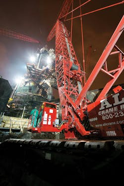

A Dominion Energy power station in West Virginia needed new chillers to cool down water before pumping it back into Mount Storm Lake. An 880-ton Liebherr LR 1800-1.0 crawler crane was ultimately specified to perform the chiller lifts. But before the crane was specified, the right crane partner was needed. In this case, the ALL Family of Companies—headquartered in Ohio with 29 branch locations—was called on to map the lift.
For complex lifts and challenging lift sites, before the first truckload of crane components ever arrives at a job site, the project has already been thoroughly mapped out, planned, and often practiced to precision. It’s a process called lift planning, and it’s a necessary part of preparing for maneuvers that involve materials measured in tons.

In addition to lifting the chiller units in West Virginia, the crane also lifted the steel needed for the chillers’ support structures. The heaviest piece weighed an estimated 188,000 pounds. The Liebherr LR 1800, configured with a 276-foot main boom, took everything in stride and executed its lifts smoothly and with precision.
