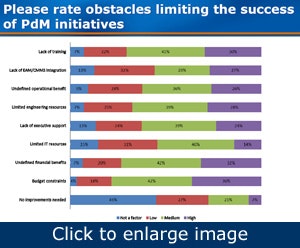

  • The primary obstacles limiting success of PdM initiatives are budget constraints, undefined financial benefits, lack of training, limited engineering support, lack of executive support, undefined operational benefit, and lack of IT support.

For managers, it’s tempting to purchase an interesting technology, learn a couple of tricks with it, and then return to business as usual. Capturing the full value from a new technology demands a higher commitment, though. According to a joint study conducted by Plant Services and ARC Advisory Group (www.arcweb.com), the primary obstacles limiting success of PdM initiatives are budget constraints, undefined financial benefits, lack of training, limited engineering support, lack of executive support, undefined operational benefit, and lack of IT support (Figure 1). The good news is that all of these obstacles are under management control. The bad news for managers is that management must take the initiative to overcome them.
Figure 1. Undefined financial benefits and budget constraints ranked as the biggest obstacles to limiting the success of PdM initiatives.

Thermal imaging, along with several other PdM technologies like vibration analysis and ultrasound has gotten a lot more flexible, friendly, and affordable in recent years. Along with that development, providers of infrared thermography equipment have done some solid training and application development work. The new training enables customers to build the knowledge base they need to support the flexible tools in a broad range of applications.
A compelling case can be made for manufacturing managers to take a fresh look at PdM technologies. They should examine their operations for the technologically driven business opportunities within real world production and maintenance problems. The result can be important improvements in overall equipment effectiveness (OEE) and reductions in operating cost. These are competitive tools that few companies can afford to ignore in the current business climate.
The obstacles to extending PdM technologies like infrared thermography can all be solved by management resolve. The correction of budget constraints, undefined financial benefits, lack of training, limited engineering support, undefined operational benefit, and lack of IT support must all come from increased management support.
