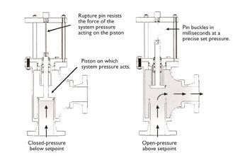

Figure 1:
One of several valve configurations that capitalize on the buckling pin technology.

The rupture pin and buckling pin valve are self-contained, self-actuating valves for dependable pressure relief or emergency shutdown at accurately predetermined setpoints. A slender, round pin -- the buckling pin -- restrains a bubble-tight piston or plunger on a seat. Low-tolerance inserts hold the pin at both ends. Too much axial force from system pressure acting on the piston or plunger buckles the pin. Once the pin is bent, subsequent valve action is full and rapid.
The buckling point obeys Euler's Law of Compressed Columns, which depends on the pin's dimensions and material of construction. The temperature-dependent modulus of elasticity is the only variable, and the materials selected exhibit a minimal change over the relevant temperature range. Because the pin is in compression, it can't fatigue. Pulsation in system pressure is not an issue. Because the pin is plainly visible, hidden corrosion is not a concern.
The valve can be pilot-operated and is certified to meet the ASME standard's setpoint variation of 5%. Valve maintenance consists of ensuring the piston moves freely at low system pressure when the pin is removed. Also, the valve can be completely rebuilt in just a few minutes.
