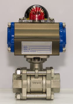

Figure 1. The high thrust strength capabilities and small sizes of double-acting actuators make them preferable for highly demanding industrial pipelines.

1. Better thrust strength
Overall, piping systems with large pipes require large valves that demand high actuating forces. It is vital to minimize resistance by the actuating mechanisms to improve the reliability and responsiveness of these valves. The presence of a spring in a single-acting actuator technically reduces the thrust strength of the actuator. The single-acting valve actuators have to be larger since they must overcome the torque of the valve and the spring forces. It translates to oversizing the single-acting actuators, meaning that more material is needed for manufacturing the actuator, ultimately increasing its cost. The springs also increase the overall size of the actuators making them significantly heavier than their double-acting counterparts.
A double-acting actuator delivers maximum actuation forces in both directions (see Figure 1). The thrust requirement for double-acting actuators is lower than that of single-acting actuators. The high thrust strength capabilities and small sizes of double-acting actuators make them preferable for highly demanding industrial pipelines.
