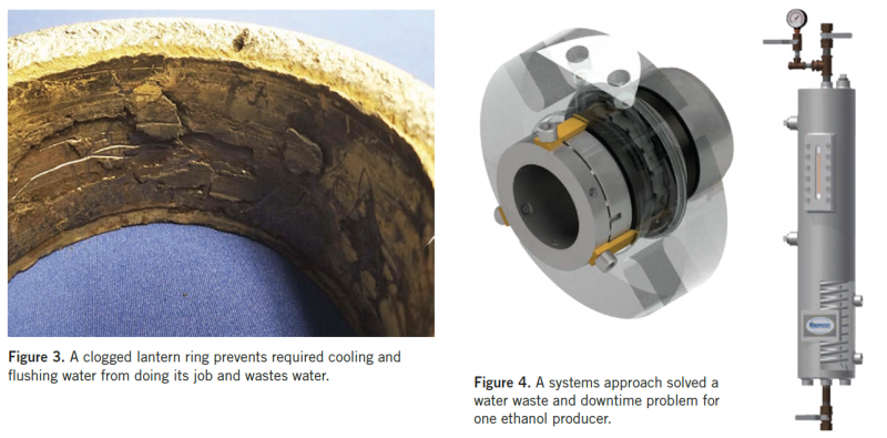

3. Appropriate flush arrangement and ideal barrier/flush fluid
Compression packing or a mechanical seal requires a cool, clean operating environment for success. To make sure the surroundings are appropriate, the following conditions must be met:
- The correct environmental control arrangement is selected.
- Ensure that the ideal flush/barrier fluid is used. Water or process fluid may not be robust enough.
- Properly set up and install the environmental controls.
- The lantern ring is unclogged and in the correct position to receive the flush fluid (see Figure 3).

In this ethanol application, the pumped fluid was being evaporated to remove water, resulting in a hot, sticky slurry moving through the pumps. When the inboard seal leaks and water is used as the barrier fluid, water leaks back into the process—the very process that is being sent through evaporators.
Once the pumped slurry leaves the evaporators, it moves to dryers. However, the cost to dry the material in dryers is many times more expensive than moving the material through the evaporator. Leakage that adds water back to this process causes water loss and increases the cost of production.
This plant needed a systems approach (see Figure 4) to solve the problem. The new system included:
- a new seal design to prevent seal failure with an integral pumping ring to ensure that the cooling barrier fluid was circulated properly
- new synthetic barrier fluid replaced water
- a convection tank with a new setup and installation position to ensure proper delivery to the seal.
The meantime between repair increased from 15 months to 37 months.
