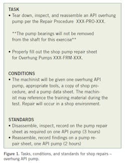

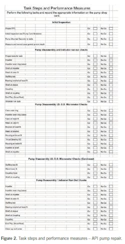

One of our classes was called “Shop Repairs – Overhung API Pump.” The task, conditions, and standards for this task are provided in Figure 1. A training class was provided for each millwright on the individual level. During the class, important steps, skills, and checks were reviewed, and applicable hands-on demonstrations were given. Next, the millwright was provided a pump to work on along with a pump repair sheet to record all information required to verify his skills. The task steps and performance measures in Figure 2 were used to verify each technician’s skills.
The fits and tolerances for the above task were found in the rotating equipment repair procedure, which was available for reference during the test as well as during all repairs. Failure of any of the above tasks would be reviewed along with the training circumstances, resulting in either failure to pass the test or an on-the-spot correction and test continuation.
