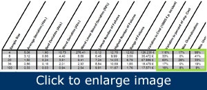

Also, the results of using the “reverse-engineered” curves in the simulation were quite remarkable. Ideally, using a sample of random numbers based on a known distribution to re-calculate its variables should lead back to the original function, or at least a similar one. That means that different samples of the same function should result in approximately the same number of failures and, therefore, cost in the simulation.
As a test, we selected five groups of samples of the same size from the same distribution function. The rows in Table 1 show the same test performed for different sample sizes ranging from 4 to 100 elements. We found that the resulting distributions differed widely. As a result, the number of expected failures ranged widely (6.45 to 9.99 in the case of eight CMMS entries). It’s interesting to note that the variation from random error is a lot higher than the effect calculated for a new investment. The results only stabilize when the sample size goes to 100 or more.
Table 1. Variations in Samples.
While these results seem quite disheartening, one must be careful not to jump to any conclusions, as this is only one case and not a comprehensive study. However, we feel confident to make several statements regarding our initial questions.
