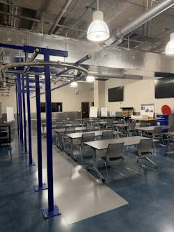

Recently a Senior Design Project team at the University of Tennessee’s Reliability and Maintainability Training Factory set out to explore the technology’s capabilities. The team is evaluating the SoterGenius tool in two phases:
- Phase 1 (1st Semester): Familiarization and preliminary test phase
- Phase 2 (2nd Semester): Utilize the technology in real-world application
