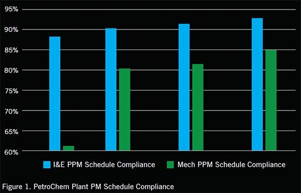

Avoid having your CMMS generate a new PM until after the previous one is marked complete. This “kicking-the-can-down-the-road” syndrome can easily change a monthly PM into a quarterly PM over the course of a year. Your CMMS should issue a new PM on a fixed basis. Tardy PMs should be closed if they continue into another period. (To avoid counting these closed work orders as done to compliance, close the open PM the day after the deadline and scrub out closed PMs with no labor hours from the list.) Hardline PM compliance demands that the PM be completed by the due date and not a day later. Figures 1 and 2 provide examples of four-month PM compliance improvement efforts, the former at a petrochem plant and the latter at a paper mill.
