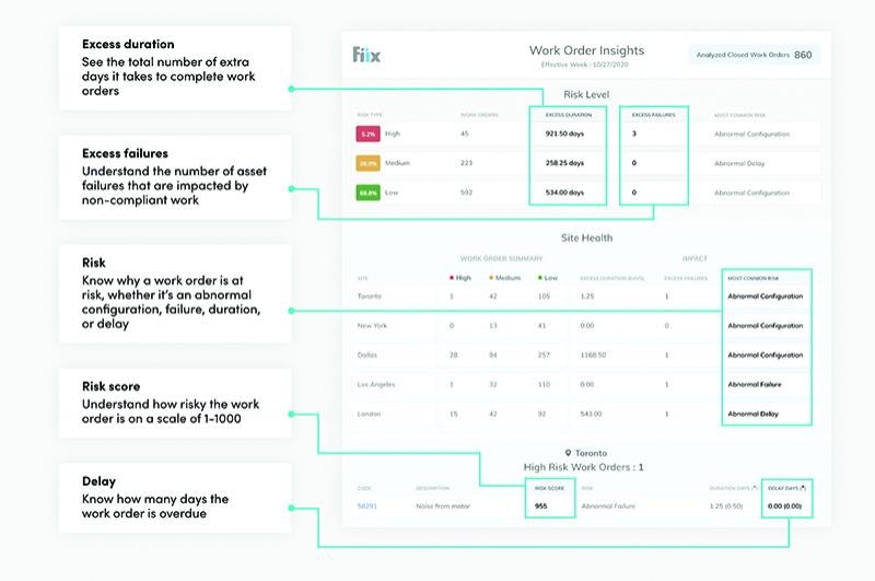

Planning, scheduling, and completing PM rounds using unwieldy maintenance management software (EAM/CMMS) wastes time and energy. It also hinders the ability to improve work order effectiveness. These were challenges faced by the largest global producer of firefighting chemicals, Perimeter Solutions. Its Fire Safety Group’s previous software required users to manually go through every work order, one by one, and they found it difficult to derive value from the data.
The Fire Safety Group became an early adopter of Fiix Foresight, an AI-driven analytics solution from CMMS provider Fiix, a Rockwell Automation company. It also recently deployed Foresight’s latest feature, the Work Order Insights report. Together, the solutions are helping its maintenance teams to better focus on the issues and improve work order performance.
The Work Order Insights report uses ML algorithms to automatically analyze thousands of PM work orders in seconds (see Figure 1). Users are alerted to issues such as abnormal work order delays, maintenance routines not working or being followed, work being executed incorrectly, excessive rework, and wasteful maintenance processes – problems that can lead to costly breakdowns and production delays if left uncorrected.
Figure 1. The Work Order Insights report uses ML algorithms to automatically analyze thousands of PM work orders in seconds to find those that are problematic. (Source: Fiix)
“To be able to look into our data instead of just keeping track of work orders is really exciting for us,” says Jose Yorba, U.S. Asset Management in the Fire Safety Group at Perimeter Solutions. “We can start seeing things we have never seen in the past, like patterns of failures. And instead of just fixing the issues and moving on, we can now ask ‘why are those issues happening’? To identify that is hugely important.”
