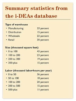

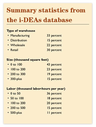

Figure 1. Typical distribution for lines picked per labor-hour. An analysis feature in iDEAs allows a comparison of your warehouse to the best warehouse in the database on a single partial productivity index, such as lines picked per labor-hour. This analysis of the performance difference on one partial productivity index can be used to estimate how much of the difference can be attributed to scale of operation, differences in technology and technical efficiency. The latter is the aspect of performance that's most directly controllable, at least in the short term. This analysis shows how much of the performance gap can't be controlled, at least in the short run, and how much represents plain old inefficiency.In addition to the resource and service data, the database also collects information on the nature of the warehouse requirements (number of stock keeping units, seasonality, variability), and particular technologies (bar coding, radio-frequency communication, warehouse management system), and practices (activity-based slotting, task interleaving) that might affect system efficiency. As the number of warehouses in the database grows, we'll be able to more accurately correlate system efficiency and particular requirements patterns, technologies and practices.Accessing the database requires a standard Web browser. Users receive a password after a straightforward registration process. The best way to proceed is to print a data requirements page and complete it off-line. Then it should take no more than an hour to key in the necessary data. The tool answers "what-if"questions:
