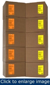

Because receiving is the point at which most plants unload and separate materials by department, it makes sense to combine these and other related actions into a single step. Elements of Kanban and 5S can complement Lean implementations and are particularly useful in helping improve receiving. Many can be integrated directly into this step to streamline the rapid and error free delivery of materials in-plant.
Typical actions in receiving often include recording receipt of materials, notifying departments the material is in house and labeling materials for in-plant delivery. When these related actions can be completed in a single step, material destinations are never a mystery. The most efficient way to organize receiving is by communicating ownership by department visually.
Figure 1. Color-coding is an excellent way to improve the visual communications in a facility. When labels and tracking cards utilize department colors, personnel can identify materials more clearly and from a distance.
Each item is clearly labeled so a maintenance technician can identify maintenance materials from a distance. Just like a well-organized filing cabinet, color-coded labels help employees find materials more quickly and with less effort. Integrating color-coded labels into a Kanban card labeling system (Figure 1) helps improve in-plant tracking, control and ultimate delivery.
