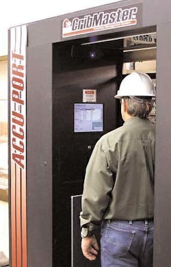

Bassett went ahead with the installation of the CribMaster Accu-Port, WinWare's RFID portal system. The Accu-Port offered a regulated solution for their tool room along with the cost-accounting system and material tracking capabilities of the CribMaster software. The Accu-Port is attached to the doorway of a store room where employees can simply walk in, grab their items and get back to work. Having access controls and a locked door (which will automatically open if the employee has permission to enter) still provides the facility with a secure tool crib, but also gives them tracking and auto-purchasing capabilities that allows their production facility to run smoothly and proficiently. As long as the items have an associated RFID tag, then each transaction will be recorded. The employees at the customer site took the ease of this process one step further by sticking their employee RFID badges in the top of their hard hats, which further automated the entry into the crib.
Before Bassett could 'go live' with the Accu-Port every item in the crib had to be assigned and affixed a RFID tag. Five thousand reprogrammable tags were purchased initially (none of which have been replaced to date) and the initial 'bag-n-tag' took about two days. Once the tag was assigned to the item it was either stuck to a durable product with its adhesive back, or consumable items were placed in laminated sleeves similar to a luggage tag.
