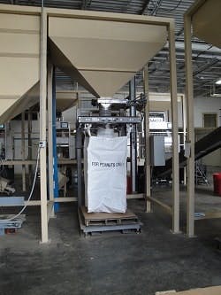

Golden Grove initially purchased one C1-2 bulk bag filler with a control panel and the equipment worked so well that the company purchased two more identical systems. The filling stations were set up as follows:
  • A large elevator conveyor is installed behind each hopper to continually deliver salted in-shell peanuts to a hopper.
  • The bottom of each hopper is fitted with a 10-in. slide gate valve operated by the control panel.
  • Spiroflow Systems C1-2 bulk bag fillers are installed under each hopper.
  • The bulk bag fillers are designed to fill customer-specified 40-in. square bulk bags. The filler height can be adjusted to accommodate bags that are 50-to-64-in. tall with corner loops 8-to-10-in. long.
  • All product contact parts on the fillers are constructed from 304 stainless steel to meet food safety standards.
  • A flexible connection is installed between the filling head of each bulk bag filler and the base of each hopper. Flexible connections are strongly recommended in a weighing application as rigid connections would interfere with accurate weighing.
  • A flexible connection is installed between the bag inflation fan and the filling head of each bulk bag filler.
  • Load cells on the bulk bag filler are connected to a Spiroflow Systems NEMA 4-certified control panel with digital weigh batch controls, slide gate valve position control, and bag inflation blower fan.
With the installation of three Spiroflow C1-2 bulk bag fillers with gain-in-weight controls, Golden Grove now has a single operator assigned to the filling area and the company fills 300 bulk bags per day. The filling process is as follows:
  1. An operator places a pallet and slip sheet on the bulk bag filler.
  2. An operator installs an empty bulk bag on to the bulk bag filler attaching each of four bag loops on to the quick release bag clips.
  3. The operator attaches the bag spout to the inflatable neck seal and inflates the neck seal so that it firmly holds the bag spout in place during filling.
  4. From the control panel the operator inflates the bulk bag with clean dry air.
  5. From the control panel the operator starts the filling process and the bag is filled within 0.5 lb.
  6. From the control panel the operator deflates the neck seal and engages the automatic bag loop release.
  7. The bulk bag is removed by forklift.
It only takes about 10 min to fill each bulk bag. The new bulk bag filling system delivers the speed that Golden Grove needed to meet its growing wholesale business demands.
