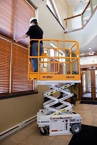

Low-level-access scissor lifts offer the same working height as ladders and scaffolding, but with greater convenience and safety features, such as 38- to 42-inch-tall railings, lanyard tie-offs and minimal setup, to name a few.

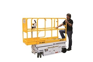

Low-level-access scissor lifts have step-in heights as low as 20.28 inches, which reduces the risk of injuries that can occur from tripping and falling. It also eliminates the fatigue created from multiple trips up and down ladders and scaffolding.
For instance, workers can more easily load materials onto a lift and move from place to place on a site. Plus, some of the lifts are equipped with overload sensors that alert the user or limit the lift height if there is excess weight on the machine.
Low-level access lifts are ready to use when they arrive on site, meaning less set-up time is needed to ensure a safe ascent. On a low-level scissor lift, workers remain on the platform and have no sides to climb or decks to assemble. Plus, low-level lifts offer working heights as high as 20 feet, so the worker can reach the exact height that offers the greatest productivity.
Push-around lifts can be lowered to the ground and pushed to the next location. These units have automatic locking mechanisms on the wheels to prevent the unsafe surfing practice. Self-propelled lifts are drivable, even while the lift is elevated, which gives users the optimum efficiency. When maneuvering around a site with a self-propelled unit, the user operates it with simple, easy-to-understand buttons, so they can focus on the wheels’ path to avoid obstacles and uneven work surfaces.
Lifts offer a fully encircled work platform with 38- to 42-inch-tall railings and toeboards. Railings prevent workers from falling from an elevated lift and toeboards protect people below from falling tools and materials. For added fall protection, some low-level-access lifts come with lanyard tie-offs. Workers have the option to attach their safety harnesses or lanyards to the tie-off, and the system will catch them if they start to fall.
