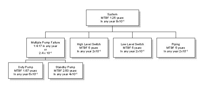

Table 1 contains some information that should immediately provoke some questions. For example, we have counted four failures in our system level MTBF, yet the table contains 13 failures. (Not counting the system failures.)
To understand this we need to review the functions for each of the components mentioned.
The function of the high-high level switch is to trip the pumping system when water reaches the high-high level. If there is a failure preventing this asset from performing its function, it will not prevent the system from pumping water. We have had one failure on the switch that we know about in this period.
Another obvious issue is the fact that we have had seven failures of the duty pump. During this time, we have also had two failures on the standby pump, a dormant function, which we know of. Because this system has redundancy built into it, we can only experience a loss of the primary function if we have a failure of the duty pump and the standby pump at the same time.
The four failures causing the loss of function at the system level were:
  • One multiple failure of the duty and standby pump
  • One failure of the high level switch, meaning the level reached the high-high level once during the five-year period
  • One failure of the low-level switch, resulting in the low-low level tripping the downstream process
  • One failure of the piping causing downtime
Figure 2 - MTBF at Different Levels
 All the other failures mentioned were either hidden to the operations team until revealed by inspection, or their function was protected by other assets (as in the case of the failures on the duty pump).
As shown in Figure 2, MTBF is useful at any level throughout an asset base. However, its application must be on the functions of the assets and the total time required of each function, at each level of performance measurement.
