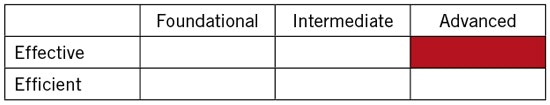

Our road map now will lead us forward to the next grid, which involves the principles that make our storeroom advanced-effective.
This intersection involves:
  • Inventory turn rate
  • Materials lay-up program
Inventory turn rate is a storeroom metric that provides an indication that the storeroom is effectively using the company’s capital. It tells us if we’re stocking the right types of parts in about the right quantity.
The formula to calculate inventory turn rate is as follows:
(Dollar value of inventoried items issued out per month, quarter, or year), divided by
(Dollar value of total inventory) – (dollar value of critical spare parts)
