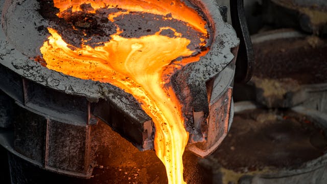

Worker suffers fatal molten metal burns, manufacturer fined $145K
During the OSHA investigation, Ellwood Engineered Castings was cited for 11 serious violations.
An OSHA investigation has discovered that Ellwood Engineered Castings Co. could have prevented the death of a 30-year-old employee. The incident occurred when the employee was working at the bottom of a pit below the casting operation. According to the agency, the Ohio industrial manufacturer did not have an effective process for containing and managing molten metal leaks, causing the worker to suffer fatal burns.
During the OSHA investigation, Ellwood Engineered Castings was cited for 11 serious violations. These violations include failing to implement an effective permit-required confined space program, not training workers on the dangers in the pit, and exposing workers to fall hazards. Because of these citations, the company faces $145,184 in penalties.
In a recent quote, OSHA Area Director Howard Eberts said, “A worker died needlessly because Ellwood Engineered Castings Co. failed to protect him and his colleagues from obvious and deadly hazards. The company could have prevented this tragedy being responsible and by following well-known safety measures.”
