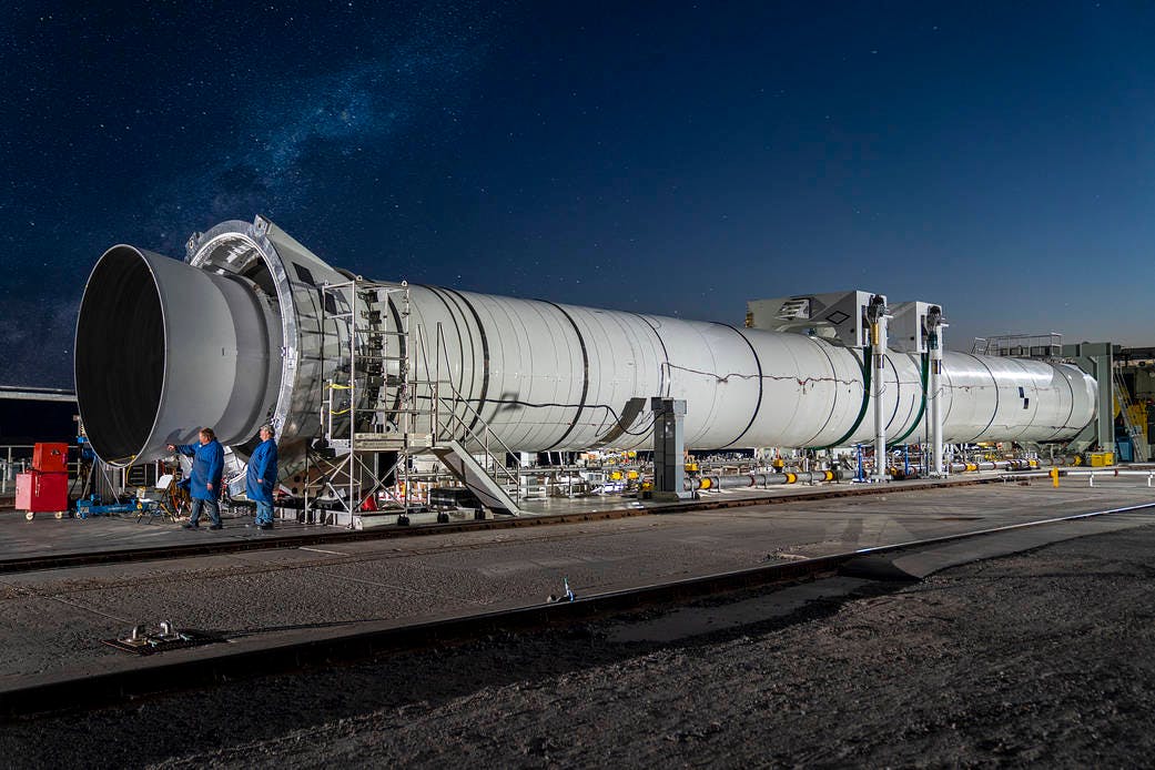

Northrop Grumman’s solid rocket boosters
Northrop Grumman is an aerospace and defense technology company headquartered in Falls Church, Virginia. The company designs and manufactures systems for space, air, land, sea, and cyber domains for government and commercial customers. The firm is a major contractor for the U.S. Department of Defense and NASA.
Northrop Grumman built two five-segment solid rocket boosters that provide the majority of thrust at liftoff. It also manufactured two rocket motors: the attitude control motor (ACM) and the abort motor for the Orion spacecraft’s launch abort system (LAS), a critical safety system that helps the crew module escape in the event of an emergency on the launch pad or during ascent, as well as the booster separation motors, which are critical for safely detaching the spent boosters.
At 7.2 million pounds of thrust, the boosters generate roughly 75% of the rocket’s thrust during the first two minutes of flight. The engines and two solid rocket boosters produce a combined thrust of 8.8 million pounds at liftoff.

Solid Rocket Booster Facts
- The twin solid rocket boosters are 177 feet tall, taller than the Statue of Liberty from base to torch, 12 feet in diameter and weight 1.6 million pounds when filled.
- Each booster burns more than 11,023 pounds of propellant each second.
- At 17 stories tall, each booster generates more thrust than 14 four-engine jumbo commercial airliners.
- The two propellant tanks collectively hold more than 733,000 gallons of super-chilled liquid propellant.
- The propellant feeding the engines on the SLS Block 1 rocket boosters consists of polybutadiene acrylonitrile (PBAN), ammonium perchlorate, and aluminum powder and has a lowered burn rate than other shuttles.
- The weight of the entire 5.74-million-pound rocket rests on the booster aft skirts.

The boosters are derived and upgraded from NASA’s Space Shuttle rocket boosters, and for the first eight flights, will use repurposed hardware from the Space Shuttle program, including forward structures, metal cases, aft skirts, and thrust vector control elements.
The major difference between the new and old shuttle boosters is the addition of a fifth solid propellant segment for a higher payload. The SLS boosters are also designed for single use, reducing the costs associated with the space shuttle’s reusable booster ocean-based recovery, post-launch assessment, and continued flight refurbishment. Deleting the recovery systems for the boosters reduced them by 20,000 pounds and opened room for additional payload.
