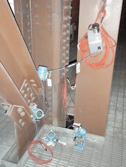

The prototype Bullet, introduced in 2009, could support six HART transmitters in field-proven HART multidrop mode. It has since expanded to eight, which is what the Performance Testing Group now uses. For either iteration, Fletcher explains this capability meant a wireless gateway could replace the failing multiplexers, and far fewer cables would need to be deployed for temporary test transmitter installations. “The economics of a hybrid wireless-wired HART system became more feasible for us to consider,” he says.
The Performance Testing Group’s wireless solution uses pre-existing Rosemount Smart HART transmitters and some key pieces of new equipment:
  • MACTek Bullets
  • MACTek HART modems
  • Siemens Simatic PDM software
  • Emerson Smart Wireless gateways
  • 24 VDC power supplies from Acopian
  • Electrical enclosures from Lowe’s Hardware
  • Mody transmitter cables — three-conductor with Neutrik 3-pin XLR connectors and five-conductor RTD cables with Neutrik 5-pin XLR connectors.
The resulting system uses the Bullets to communicate HART data, including the process variables, through the Emerson gateway, into a laptop PC, where data are imported to an Excel spreadsheet using Matricon Analytics’ plug-in Excel Reporter, an OPC plug-in.
MACTek’s Bullet is designed to provide access to real-time information from installed intelligent HART-enabled field devices. It is available in general purpose as well as in certified intrinsic safety and explosion-proof models. The Bullet recognizes each HART-compliant device and sends that information back, with the instrument’s tag name, so the team’s data acquisition can import field data.
Before its first use, the Bullet and WirelessHART protocol were subject to an IT security review in compliance with North American Electric Reliability Council — Critical Infrastructure Protection (NERC-CIP) requirements and passed with flying colors. “While we were able to show no connection to the plant’s cyber assets, they were impressed with the security of the encrypted HART protocol,” says Fletcher, who has one caveat to using the wireless network adapters. Because WirelessHART technology uses the same 2.4-GHz frequency band as Wi-Fi, users should be aware of the range limits and possibility of interference between objects and antennas.
However, in actual use, it turned out that the Bullets don’t necessarily need be in line-of-sight to establish a network. He also notes that a WirelessHART network can take 10 or 20 minutes to get fully established with all HART subdevices reporting, “but the radio links will form in circumstances that Wi-Fi couldn’t hope to achieve, and they just work,” says Fletcher. “Wi-Fi was designed for speed, while WirelessHART was designed for data reliability.”
