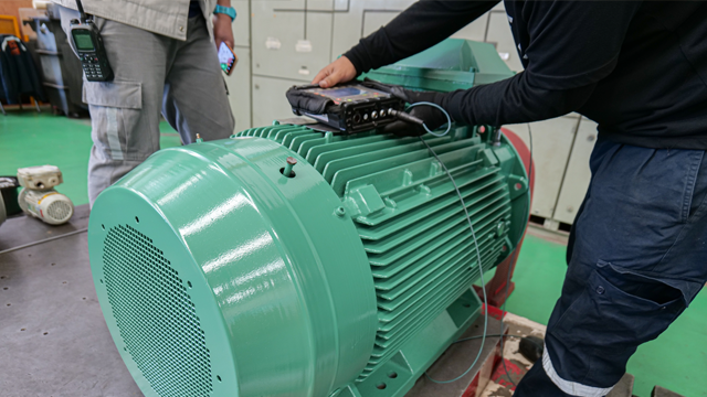

PS: You mentioned surge testing. Can’t I use an impedance tester instead of a surge tester?
HDS: Oh, no. We get that question frequently. Impedance testing attempts to do what the surge tester does, but it tests at like 5 volts. Now if you've got a 13,800 volts stator winding, then testing at such a low voltage (unless there is a dead short somewhere in the winding) you will not see anything. These are large machines. You need to test them at an elevated voltage, even exceeding the supply voltage, so that you can find even weaknesses in the installation before it has failed. So definitely not an impedance tester; a surge tester, yes.
