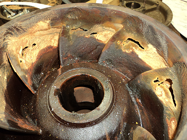

Even if unbalance is isolated from all the other defects and confirmed to be the only defect, unbalance still can be induced by a long list of fault modes, like corrosion/erosion (Figure 2), un-even porosity flaws during manufacturing, process material build-up, oversize key, and un-symmetrical electrical winding coils. Sometimes, the root cause is impressive; for example, vibration during startup can be amazing after the motor was idle for months, because a big wasp nest is built on the motor cooling fan.

As a temporary antidote, field balancing, can reduce high vibration appreciable by human, however, the internal stress does not,3, 4, 5 which is a silent killer. Take an 1800 RPM rotor for example; with any existing fatigue stress, it repeats more than 946 million cycles a year, for 24/7 operation. Figure 5 is a shaft broken by rotational bending fatigue failure mode, which slowly develops from origin (left upper corner) at early stage before sudden failure at Instantaneous Zone (right lower corner) without warning. That is why each component on a multiple stages train (impeller, gear, coupling, pulley, shaft, etc.) needs individual balancing first and a final trim after having been assembled together to eradicate the side effect, which is stress fatigue or stress when it is rotating. Precise balancing is the only way to remediate this defect, and can be done during manufacturing or major turnaround. There is no short cut.
