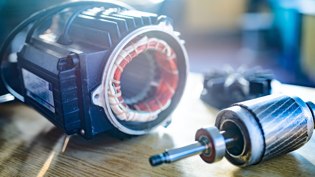

This step ensures the motor itself is healthy and in good operating condition. Proper practices are vital for many years of problem-free motor operation. Recording all maintenance steps and test results is essential for setting a baseline and seeing trends that determine when a motor is failing.
Bearing lubrication requirements vary greatly from motor to motor. Lubrication intervals are affected by the motor type, its operating rpm and, most importantly, the environment. Severe environments will require more frequent lubrication.
The proper procedure is to clean the grease fitting first, open any purge fittings, and wipe off the grease fitting when done.
It is best to use the manufacturer’s recommended grease, but if that isn’t possible, ensure that the one used is compatible with the original grease.
Never overlubricate. This is one of the top reasons for premature motor failure.

Simple inspections, such as the following steps, can provide favorable results in motor health (see Figure 2):
  1. Clean excessive dust, dirt, or debris that may have accumulated on the motor’s frame. A clean motor dissipates heat properly. If the motor is located in a severe environment and nearly impossible to keep clean, consider using protective motor covers.
  2. As with the MCC testing, check that all electrical connections are tightened to the manufacturer’s recommendations using a calibrated torque wrench.
  3. Visually inspect all power cables and perform a resistance test. Replace any worn or damaged cables.
  4. Periodically remove critical motors on variable frequency drives (VFDs) from service. If bearing inspection reveals pitting, this signifies shaft current leaks caused by the pulse with modulation (PWM) sine wave of the VFD. Install shaft grounding rings to mitigate this problem. Consider upgrading to VFD-rated cable and adding shaft grounding devices if bearing damage is an ongoing issue.
