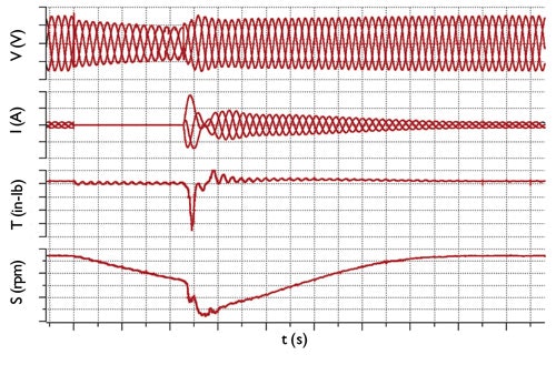

The worst case for the 10-hp motor at 100 percent of its rated load occurs under high load inertia, when power is interrupted for 5.5 cycles (92 milliseconds on a 60-Hz line). Figure 1 shows the transient data for these conditions. The graphs, from top to bottom, respectively, show the motor terminal voltage, motor current, shaft torque and shaft speed, each plotted as a function of time.
Figure 1: Interrupting power under high-inertia loading produced a negative torque transient 20 times the motor's rated torque.
The motor is operating at steady-state condition when, at time t = 0, the motor supply voltage is removed and reapplied 5.5 cycles later. Upon reconnection, the motor's back-emf is approximately 194 out-of-phase with the line voltage. To realign the rotor currents, the motor suddenly decelerates, which produces a negative torque transient that reaches -7,300 in-lb, a value 20 times greater than the motor's rated torque.
