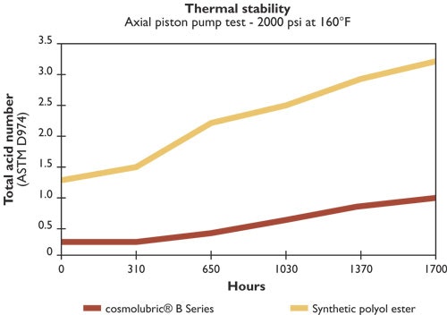

Vegetable oils or naturally occurring triglycerides are in the same chemical family as polyol esters. Fully compounded vegetable oil fluids are more than 90 percent biodegradable. Their low total-acid numbers contribute to their good chemical stability and acceptable thermal stability. Their corrosion protection is excellent. While they are good lubricants, their tendency toward rapid oxidation at elevated temperatures has raised concerns about their performance.
A high concentration of linoleic and linolenic fatty acids causes oxidation instability. These acids are characterized by two and three double bonds, respectively. Research shows that the oleic-acid ester distribution in a naturally occurring ester-base stock plays a major role in fluid performance. More double bonds make a material more prone to rapid oxidation. In addition, a high degree of unsaturation leads to increases in viscosity and total acid number, as well as aggressiveness toward copper and copper alloys. However, combining specially formulated additive packages with selected vegetable oil base stocks overcomes these deficiencies.
Additive technology provides fire resistance consistent with Factory Mutual guidelines. Tests have demonstrated that additive technology can enable vegetable oils to perform like polyol esters. This is because the formulations for finished synthetic polyol ester and naturally occurring triglyceride fluids are identical (with the exception of the ester base stock). Both contain viscosity index modifiers, rust and oxidation inhibitors, extreme-pressure additives, copper passivators and defoamers.
Laboratory tests
Several laboratory tests have tried to determine whether additives could fortify vegetable oils to improve their oxidation stability to that of synthetic polyol esters. The research began with canola oil base stock with additives for benchmark comparison against a commercial, premium synthetic polyol ester fluid. When testing was completed, the canola oil with optimized additive package was found to provide overall performance comparable to the synthetic fluid, including:
LubricationWhen properly formulated, both fluids passed FZG stage 12; Shell 4-Ball results (1,800 rpm, 40 kg, 1 hr, RT) were 0.30 mm.
Pump TestingThe Vickers 35VQ Vane Pump Test is a severe, mobile-equipment wear test. The standard test procedure requires that the same charge of fluid be tested with satisfactory results in three successive 50-hour test runs. Total ring and vane wear must be below 90 mg in each run. A commercial vegetable oil-based fluid passed the test. Results from ASTM's D2882 pump-wear test also were exceptional. Ring and vane loss was less than 12 mg for both the synthetic polyol ester and properly formulated canola oil. These results are on par with high-performance hydraulic oil.
Oxidation stabilityThe Rotating Bomb Oxidation Test results ranged from 55 to 180 minutes for several synthetic polyol esters and 165 minutes for canola oil with an optimized additive package.
These tests and others prove that in terms of lubricity, oxidation stability, fire resistance and overall greater biodegradability, a fluid based on naturally occurring triglycerides can be formulated to perform as well as a synthetic polyol-ester fluid.
