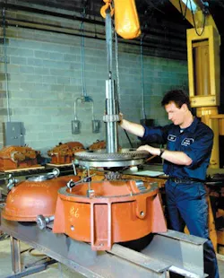

Avoid this
Use effective preventive maintenance to avoid having to shut down a line to perform shop repairs.Vibration analysisVibration is a key diagnostic of machine faults. Machine geometry and operating speed determine vibration frequency. Each machine fault generates a specific vibration profile, and a single vibration signature can provide information about multiple components.
