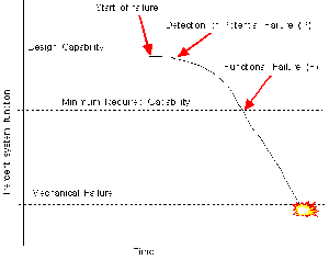

It’s useful to think about the process of failing in terms of a PF Curve (Figure 2). This curve illustrates the relationship between the failure symptom and time. There’s a point where the symptom is sufficiently developed to be detected with confidence. This is called the P point, or potential failure point. The value of the symptom when the process is no longer capable of meeting requirements is called the F point, or functional failure point. Note that the F point is not necessarily the point of mechanical break up.
We want to find a measurable variable that meets several criteria. First, it must be a reliable indicator of machine health and a reliable measure of a symptom. It must be capable of being measured economically. And, it should give sufficient warning so there’s time to react.
