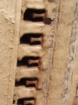

The motor failed again in September 2005. Inspection revealed that the armature installed in 2002 had gone to ground near the pinion end, a common location for a failure with a motor of this style because the coil can be moved under magnetic and centrifugal forces where it exits the laminations. Although this movement is small, it’s adequate to tear insulating paper and crack varnish, especially after thousands of repetitions in the course of operation.
This explains why proper banding is critical -- it restricts this motion. Inspection of the failed area revealed loose banding and a distinctive chevron crack in the insulating varnish at the end of every coil slot (Figure 6 and Figure 7). Evidently the banding repair had failed enough for the coil end turns to move. In a higher-speed machine, centrifugal force probably would’ve thrown the coils completely out and stopped the machine. In this case, the looseness allowed the insulation to crack until one of the 800 or so coils grounded.
Figure 6. Loose banding resulted in this hole in the armature.
Figure 7. Loose banding produced these distinctive chevron cracks at the end of every coil slot.
