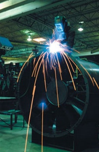

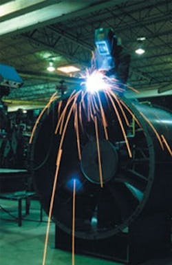

Many industrial operations, such as electric welding, can generate harmonics.
Harmonics problems usually aren't catastrophic, but they can cause equipment overheating, erratic system operation, nuisance tripping and noise transfer to other loads. This can lead to equipment damage and production downtime. In extreme cases, utilities can impose penalties on power users or even disconnect a facility from the power grid until harmonic problems have been resolved.

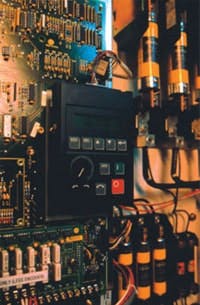

A typical plant installation may include drives alongside other electrical elements
Drives using pulse width modulation technology with the least distortion today are 12- and 18-pulse AC variable frequency drives. They produce little transient noise and can offer a total harmonic distortion of less than three percent. And with a 0.95 power factor, or better, these drives eliminate the need for power factor correction capacitors and tuned inductors.
Power factor is the percentage of usable real power (in Watts) to the utility-supplied apparent power (in volt-amps). The closer a product can come to achieving a 1.0 power factor, the better. In most cases, a power factor of 0.85 or higher is considered sufficient by the utility.
What's important to understand is that there is more than one way to approach the harmonics problem. And the most expensive method may not always be the best choice. It's not uncommon for power users to oversize the solution to eliminate a perceived harmonics problem. But this oversizing correlates directly to cost increases that could be avoided by better assessing harmonic mitigation options.  Table 1 provides a cost-performance-size comparison of various drive harmonic mitigation solutions.
