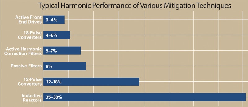

Reactors or chokes: The first approach to reducing harmonics from a drive is to add impedance, either in the form of an AC line reactor or DC bus choke. Typically, this is a low-cost and technically simple solution, but it’s likely to reduce only higher-order harmonics and has little effect on the 5th and 7th harmonics. Additionally, there’s an associated voltage drop, which means there are limits to the amount of impedance that can be added.
Both AC and DC reactors deliver similar harmonic mitigation, but AC reactors provide additional protection to the drive rectifier bridge. Reactors are typically rated between 1.5% and 5% — the industry standard is 3%. Because of diminishing returns and voltage drop, higher percentage reactors seldom are used. Typically, 3% reactors yield about 35-38% current distortion, with 5% reactors dropping this to 33% to 35%.

12-pulse converters: These incorporate two separate AFD input semiconductor bridges, which are fed from 30° phase-shifted power sources with identical impedance. This arrangement allows the harmonics from the first converter to cancel the harmonics of the second, especially the 5th and 7th harmonics.
Twelve-pulse converters reduce voltage and current harmonics as much as 85% when compared to six-pulse AFDs. This results in about 12% current distortion. However, the 12-pulse converters have been largely superseded by 18-pulse converters on larger-horsepower systems because of the significant harmonic attenuation benefits provided by the newer technology.
On systems smaller than 100 hp, 12-pulse converters have been largely superseded by passive filter solutions because of cost.
Passive filters: Designed for small and mid-size applications, usually smaller than 100 hp, passive inductive and capacitive (L-C-L) filters block harmonics from being transferred to the electrical distribution system. They reduce line harmonics at the drive input terminals, resulting in approximately 7% current distortion. A high-impedance primary inductor blocks higher-order harmonics, while a shunt-connected tuned reactor connected to a capacitor mitigates the 5th and 7th harmonics. Passive filters are a low-cost popular solution. Further, modern passive filter designs do a better job in cleaning up harmonics from the drive only, as opposed to the traditional designs which absorbed system harmonics and became overloaded.
The drive manufacturer should provide and install harmonic filters in the same enclosure as the drive. Following this practice ensures the passive filter is sized correctly for the drive.
Figure 2. Degrees of current distortion remain after treatment with various technologies.
Active harmonic correction filters: These are high-performance inverters that measure system harmonics through current transformers and inject harmonics of equal amplitude and opposite phase into the system. This can be suitable for systems where low-horsepower loads are numerous and diverse, as a single active filter can mitigate the distortion effects of many drives. They also can be useful for retrofit applications, because they’re a shunt-connected device. These systems typically are costly and rarely applied to single-drive, high-horsepower applications.
Active front end drives: The active front end drive is newer technology designed for regenerative loads and has an added benefit of reducing harmonics. This device combines the characteristics of the active filter and passive filter as it requires an inductive-capacitive filter to separate the high frequency IGBT switching from the line. The expense of an active front-end drive can be prohibitive in a variety of applications and is more fitting only for regenerative and common DC bus applications.

18-pulse converters: A simple, single-source solution, an 18-pulse converter is well-suited for critical loads to provide comprehensive protection for critical equipment. Drives with 18-pulse converters meet IEEE 519 standards by reducing current distortion to 5% or less. Reducing harmonics at the drive input terminals stops harmonics at the source. Further, the 18-pulse converter increases drive life by means of a stable DC bus voltage. Providing 50% better harmonic ratings than 12-pulse converters, the 18-pulse converter is, when looking at the combination of harmonic mitigation and cost, the most effective solution at 100 hp or more. In addition, by using passive components such as diodes, rectifiers and transformers, the 18-pulse drives provide the most rugged solution (Figure 2 and 3).
Eighteen-pulse converters have a near sine wave input current and low harmonics. An efficient, new technology, the 18-pulse drive has helped manufacturing plants around the world reduce harmonics. Key advantages include:
