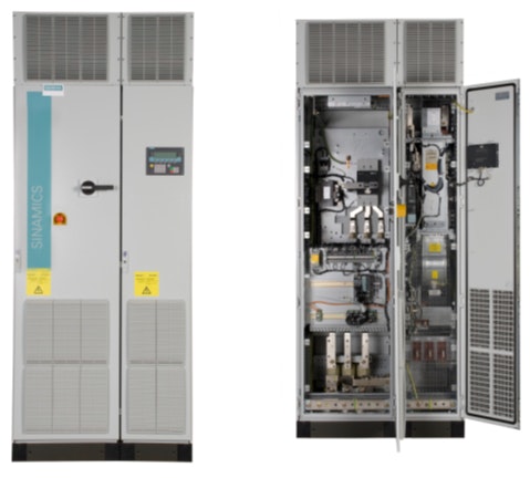

Figure 4. 400 hp, drive with active front end (active infeed)
This type of VFD (Figure 4) has a line-side IGBT converter/rectifier and clean power filter. A line-side rectifier of at least the same current rating as the motor-side inverter provides a controllable power factor of 0.8 lead to 0.8 lag. With a smaller rectifier, the unit can operate at unity PF. The active front end, by definition, is inherently regenerative and can feed power back into the supply system when the motor is braking.

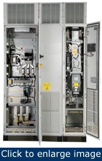

Figure 5. 400 hp drive with integral harmonic filter
The six-pulse VFD with integral harmonic filter is a standard six-pulse drive with the addition of a line harmonic filter integrated into the drive lineup. This configuration provides benefits such as a single enclosure, protection by the drive circuit breaker and fuses. The short-circuit current rating (SCCR) applies to the complete enclosed drive unit, and there’s no need for external protection upstream of the filter. Nor will you need extra power or control cabling for overload or temperature protection. (Figure 5).
The new line-harmonic filter (LHF) design features a reactor with zig-zag windings (windings from three phases on a common core) to provide some degree of harmonic cancellation. The reactor is combined with a small capacitor bank that results in a compact design, about 16 in. wide for 150 to 400 hp and 24 in. for 500 hp to 800 hp. The THID is approximately 8%, while the PF is unity at full load, capacitive at partial loads, which might present a difficulty on a weak supply network or with small backup generators, less than three or four times the drive rating. The harmonic limits might be exceeded with weak supply systems (Figure 6).
Figure 6. Line side components, LHF and power module shown in CAD
In addition to the compact design, these VFD units typically have a lower cost, higher efficiency and are suitable for safe operation on generator supplies, provided the total drive load is around 25% to 30% of the generator rating, for example, on marine vessels or other remote applications.
