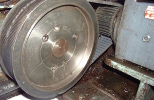

Gates PolyChain GT2 belt and sprocket system has reduced maintenance efforts at Georgia-Pacific's Bradford, Pa., facility.
Smith tackled the problem by installing hardened sprockets, but he says the chain was always stretching, showing signs of extreme wear and needing frequent replacement. He called Gates Power Transmission Product Applications and Motion Industries for help. In less than a week, the Bradford plant had a new Gates PolyChain GT2 belt and sprocket system on the head drive.
The PolyChain GT2 synchronous belt features a polyurethane body, aramid fiber tensile cord reinforcement and nylon tooth facing. These features allow it to transmit positive power over a range of loads while withstanding power surges and shock loads.
The Gates belt drive is maintenance-free and much quieter than the former chain system, according to Smith. "Now, there is no high maintenance in this area, and we remove the cover only during regular inspections," he says. Another big plus is that they no longer need to apply lubrication. Smith says they have eliminated the constant oil mess on the machine and surrounding area. This has eliminated unexpected down time and allows Georgia-Pacific to ship products on time.
