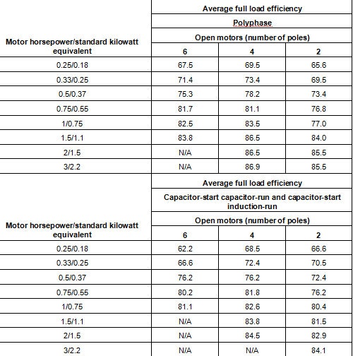

New-model motors in most cases may be slightly larger in both length and diameter than older motors because the higher efficiency specified by the DOE's new standards demands the use of more active material. Users of single-phase motors also may see some ratings change from capacitor-start–induction-run to capacitor-start–capacitor-run.
Figure 1 shows the average full load efficiency required for polyphase and single-phase motors manufactured after March 9, 2015 (or after March 9, 2017, for the small subgroup of small electric motors that require listing or certification by a nationally recognized safety testing laboratory).
