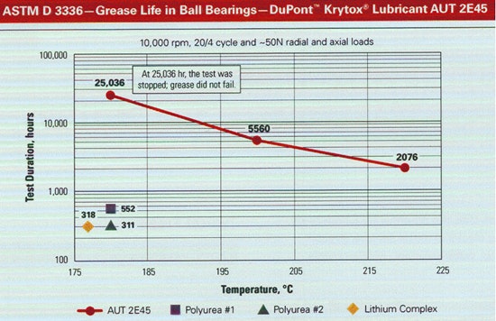

From the early 2000s it has become possible to capitalize on another option: perfluoropolyether (PFPE)-based “Krytox®” greases. These PFPE-based lubricants are non-flammable and offer extremely high tolerance to heat and chemicals. Grease life comparisons with traditional greases are highly favorable (Figure 1): PFPE-based lubricants will not oxidize or gum up like other greases, nor can they be displaced by low-pressure steam and water.

Figure 1. PFPE-based lubricants will not oxidize or gum up like other greases, nor can they be displaced by low-pressure steam and water.

It was at that point that the PFPE alternative became very attractive, and the data in Figure 1 pointed to the likely superiority of Krytox® PFPE greases over the alternatives. Seven years later, the mill had successfully converted bearings to PFPE-based greases in over 100 motors. They also stocked more than 150 additional PFPE-based grease-filled sealed bearings, and planned to swap these into motors as the old bearings failed.
From the start of the PFPE greasing program, the mill has not had to replace any electric motors using PFPE grease, nor have they had a single bearing failure in an electric motor using PFPE lubricant. On top of the reliability successes, the use of PFPE grease has helped provide a simple solution with less manpower. For this mill, it clearly proved the most cost-effective option and seven years of tracking showed the mill to have nearly doubled the life of their electric motors. The labor component of periodic re-lubrication no longer exists, and each avoided motor replacement event saves the mill at least $4,000. To this Canadian paper mill, any maintenance program requiring periodic re-greasing would have meant more manpower and added overhead costs.
