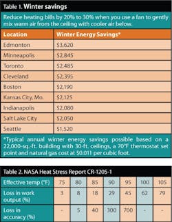

Because HV/LS fans are efficient, their return on initial investment often ranges from six months to two years. Payback on an HV/LS fan varies according to a number of application variables. As shown in Table 1, winter energy savings are substantial. Users can reduce their heating bills by 20% to 30% when using an HV/LS fan to gently mix warm air from the ceiling with cooler air below.

A NASA study (Table 2) found that as effective temperature rises, work output and accuracy plummet. The study also found that moving a steady, light breeze across people’s bodies produces an evaporative cooling effect that reduces the effective temperature by 10°F to 12°F.  The effective temperature corresponding to 84°F and an air speed of 3 mph is 73°F. Air moving faster than 5 mph provides no additional cooling effect.
