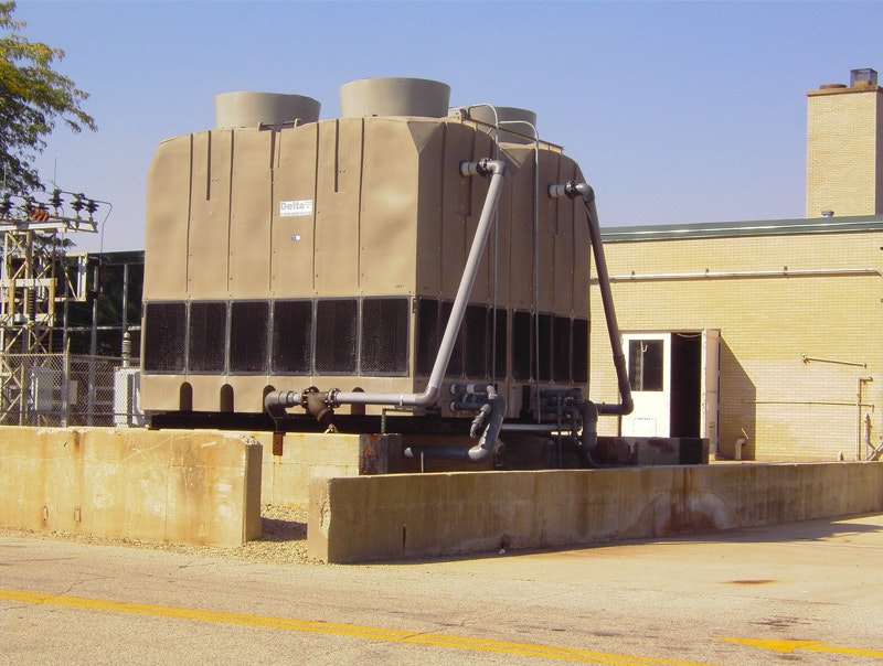

Just as with automobiles, the need for cooling tower maintenance – both routine and preventive - is more pronounced in the summertime. Fill material or wet decking should be serviced or replaced. Fouled fill material won’t allow sufficient air volume to contact the system’s water to dissipate heat efficiently. Therefore, it’ll make the fan(s) and motors work harder, adding significantly to energy costs or, worse, make them unable to achieve required cooling temperatures.
“If you’re running water through fouled cooling tower wet decking, you’ll not get the necessary heat dissipation, and the water getting down to the sump won’t be cold enough for the processing equipment,” adds Ryder. “Wash down the ventilation louvers, as well as the wet decking, which facilitate the cooling evaporation process. Check drift eliminators to prevent unnecessary water loss. Plus, make any repairs such as patching, welding or cleaning of cooling tower sheeting as required.”

“But even a cooling tower as durable as these plastic models still should receive inspection and maintenance in preparation for hot weather,” says Ryder. “You should clean the PVC fill or packing material, you should ensure the louvers are clean for optimum air flow and minimize need of the electric fan, and you should ensure that drift eliminators are operational. That will go a long way toward avoiding cooling tower fatigue for many years to come.”
