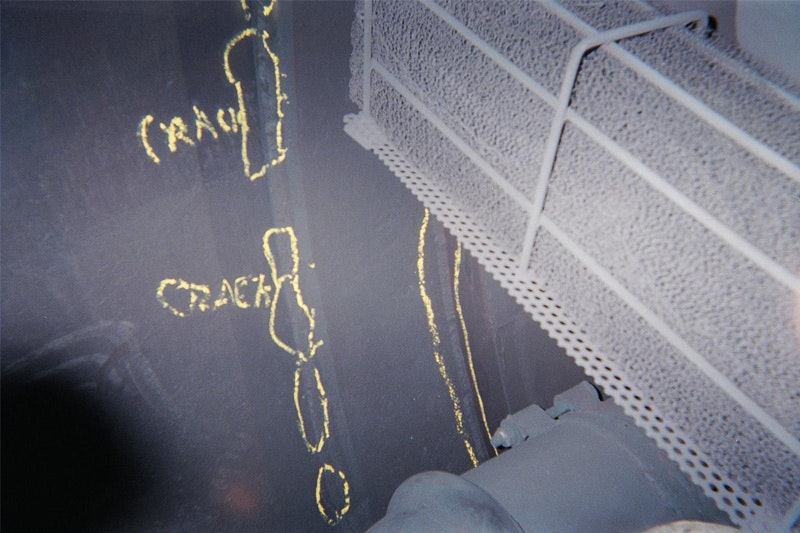

 Figure 2. Look for cracks in the heat-affected zone at the head-to-shell weld.
The last and probably the most important inspection in the drum head is a visual examination of the head-to-shell attachment welds. This examination requires that any standing water and debris be removed and the circumferential weld area including the heat affected zone (HAZ) be cleaned on the lower half of the boiler drum (Figure 2).
After cleaning, inspect this weld area closely for circumferential cracking at the edges of the heat affected zone, transverse cracking across the weld, and any porosity (both linear or cluster porosity). If the weld has been subjected to long periods of acidic boiler water, then the weld’s profile will be either indistinct or completely absent.
