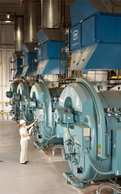

Figure 1. The criticality of steam quality varies by application, but the best way to alleviate steam-quality issues is to maintain the quality of the water. (Source: Cleaver-Brooks)

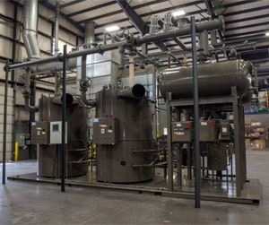

Figure 2. Inherent steam quality is based on conservative design of the boiler and the piping. (Source: Fulton Companies)

The best way to alleviate steam quality issues is to maintain the quality of the water, says Cleaver-Brooks’ Vasudevan. “Water has some impurities, like silica, dissolved salts, and organics,” he says. “To prevent impurities from water particles from being carried over, you need to use better quality water, monitor it on a regular basis, and maintain it within the industry standards for recommended water quality based on the steam pressures used.”

Inherent steam quality is based on conservative design of the boiler and the piping, says Fulton’s Wadkinson. “The technology is not new, but it is often overlooked in today’s cost-driven market where newer boilers entering the market are designed and constructed to reduce manufacturing costs,” she says.
