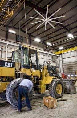

Mechanics working in a shop sized to fit the massive on- and off-road heavy equipment that keeps Luck Stone’s rock quarry products on the move were struggling to stay comfortable year-round. In the winter, all the heat rose to the top of the 30-ft ceiling, leaving technicians shivering below, particularly when the four large bay doors were opened to move equipment. The temperature differential between the floor and a second-story loft was as high as 9 °F.
“We were basically heating the rooftop of the shop,” says Mark Endries, project manager at Luck Stone in Richmond, Virginia. “We tried several different things to bring that heat down here and provide comfort, with limited success.” Typical small ceiling fans didn’t make any difference in the tall space, and Luck Stone needed a bigger solution.
“We recognized we needed a way to improve the comfort level of the mechanics working in the shop, while being operationally efficient and environmentally conscious, too,” says Endries.

At Luck Stone, the fan is used to keep employees comfortable on hot days, as well as cool. The single overhead fan replaced several noisy floor fans on the shop floor.
“Taking out the floor fans cleared up some space and got cords out of the way,” says Endries. “Our people used to take breaks to get water or cool off in front of the floor fans, and I think our productivity may have been a little off because of them needing to cool down.”
The fan keeps Luck Stone’s technicians comfortable year-round and has become standard equipment in the shop, says Endries. “In the winter the Big Ass Fans fan pushes down the warm air at the ceiling very effectively, and in the summertime it creates a breeze. That fan runs every day that we’re working.”
