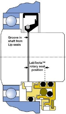

In any event, keeping water away from the bearing is a sound remedy. Magnetic bearing housing protector seals are ideal for the flooded lubrication in vertical pumps. Non-contacting labyrinth seals, not lip seals, (Figure 3) are best for the majority of horizontal centrifugal pumps.
Shaft-Contacting Lip Seal, Top, vs. Non-Contacting Dynamic O-Ring Seal, Bottom. (Source: AESSEAL, plc, Rotherham/UK and Knoxville, Tennessee)
