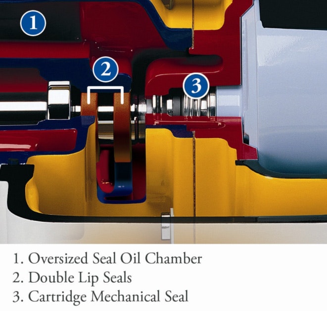

Shaft seals
Figure 2. Attention to the seal area of the pump can extend its life.
Historically, there are two approaches to do this. Mechanical seals allow for nearly zero leakage. Packing, on the other hand, allows a small amount of leakage along the shaft. Mechanical packing, however, isn’t considered state-of-the-art because it decreases efficiency while increasing the need for maintenance. The packing often scores the pump shaft, making it difficult to reseal and requiring a shaft repair or a replacement.
A variable is whether there’s a reservoir of lubrication for the seal. An oil reservoir helps to lubricate and cool the seal, extending seal life (Figure 2). Of further concern is dry-running or a blocked suction line. When a spinning pump isn’t moving fluid, an alternative means of lubrication greatly increases seal life.
Still, if a pump requires frequent maintenance, consider using a cartridge seal, which usually carries a price premium. Another option is a relatively inexpensive, fully internal pump cartridge seal, which can be used on many pumps (See Fig. 2). It requires minimal disassembly to install properly.
Furthermore, seal sleeves, which protect the mechanical seal, are a vital consideration. Without one, the shaft itself might become damaged during the life of the pump, requiring the entire shaft to be replaced. Sleeves act as sacrificial parts, but, in an effort to cut financial corners, end-users at times overlook the additional value.
