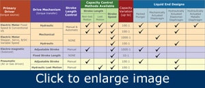

Controlled-volume metering pumps are used in a wide range of applications and environments. Process pressures can range from atmospheric pressure to 50,000 psig (3,500 Bar). Pump capacities per head vary from 10 ml/hr to 5,000 gal/hr. Several types of metering pumps have evolved to best suit each application to meet this range. Drives, control methods and liquid-end combinations have been designed to handle the full scope of applications (Figure 1).
Figure 1. This chart details the performance and mechanical characteristics of the standard array of metering pumps.
