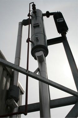

Figure 2. An image of a permanently installed LERK.
Two ways in which light ends can be removed from a HTF system are batch venting and installation of a light ends removal kit, or LERK (see Figure 2). Batch venting refers to the process of heating the expansion tank and raising the temperature of the circulating HTF. This will vaporize the light ends and hence remove them from the HTF and HTF system. The downside to batch venting, however, is that the increased temperature will increase the rate of oxidation according to the Arrhenius rule and accelerate thermal degradation of the HTF. A nitrogen lance can be used to negate the effect of oxidation, but by its nature, batch venting is an aggressive approach and continued until no further light ends are collected.
In contrast, a LERK is installed and removes light ends continuously via distillation. This means that light ends can be removed while the HTF system is in operation and does not require the header tank to be heated. A LERK also offers the advantage of being able to be installed temporarily or permanently. Once installed, a LERK stops the flammable vapors from building up; this means that the flash point of the fluid is maintained relatively constant.

Flammable vapors can be removed by batch venting or via installation of a LERK, as both have been shown to be effective. The clear advantage of batch venting is that it is cheaper than installing a LERK. In contrast, a LERK is more expensive, but it can be installed temporarily or permanently and removes light ends continuously. Indeed, a research article published in Heat Transfer Engineering (Vol. 37, Issue 15) showed a LERK was still working effectively in a food processing plant more than five years after its initial installation (also see Figure 3).
Unlike with batch venting, a LERK can be built into a system or temporarily plugged in as needed without leading to costly interruptions in production. Lastly, batch venting is quite an aggressive intervention that can ultimately accelerate the degradation of the fluid. This can be avoided by installing a LERK.
