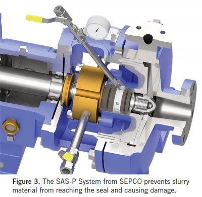

Noncontact tandem seal
Centrifugal pumps that move slurries endure abuse from entrained particulates and other solids. A mill in south central North Carolina that produces packaging and tissue products was dealing with repeated failure of a hydrapulper discharge pump due to its single cassette mechanical seal only lasting a week or two at best. The pump’s wet end was slotted with a concrete pad instead of being bolted down, causing excessive pipe strain and ultimately failure of the mechanical seal.
The failing seal was replaced with the SAS-P System, a noncontact tandem seal from SEPCO that uses air to seal and water to flush and clean the stuffing box, thus preventing the slurry material from reaching the seal and causing damage. Designed for centrifugal pumps, it incorporates two shaft-supporting bushings, an air seal, and a lantern ring (see Figure 3).
Because the air seal is noncontact and floats above the shaft, the system is impervious to conditions that damage or destroy traditional seals and pumps, such as pipe strain, misalignment, off-BEP operation, and cavitation, says Chris Wilder, CEO of SEPCO.
The new system increased the pump’s uptime significantly. “Since the SAS-P installation more than 11 months ago, we have had zero failures,” says the mill’s maintenance supervisor, who now plans to expand the system’s use to other pumps in the mill.
