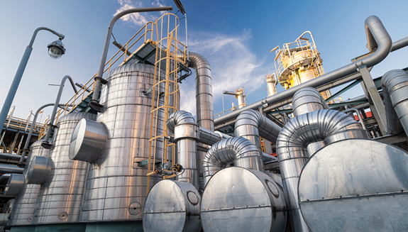

Molecular sieve dehydration removes water vapor from hydrocarbon streams using a highly effective desiccant process. In industry, these dryers are commonly found in cryogenic gas plants, liquid natural gas terminals, liquid natural gas liquefaction plants and ethylene plants, amongst others. All of these processes require very low levels of moisture in hydrocarbon feeds for efficient operation, necessitating improved valve designs.
Process layout
In a molecular sieve dehydration unit, the hydrocarbon fluid flows over the adsorption beds to remove moisture. As the beds reach saturation, switching valves reverse position, allowing hot regeneration gas to dry and regenerate the spent molecular sieve bed. A molecular sieve unit can contain two or more beds, with one bed being regenerated while the other(s) are drying gas (see Figure 1).
