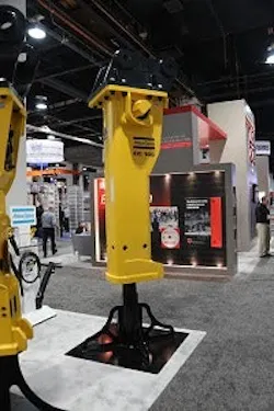

Atlas Copco has added three new hydraulic breaker attachments to its Essential Case-Mounted (EC) range to fit 22- to 49-ton carriers. The new, Heavy Range breaker attachments – the EC 140 T, EC 150 T and EC 155 T – like the full line of EC breakers, give rental centers and contractors fast ROI by simplifying maintenance and operation.

The EC breaker attachments feature Atlas Copco's box-style mounting systems, which eliminate the need for removing external fasteners to access components, such as wear bushings and seals. This translates to expedited turnaround times for maintenance and, as a result, higher utilization rates.
The heavy-duty attachments are as light as 4,000 pounds and generate impact rates as high as 800 bpm to deliver effective impact energy to the breaking surface. With their high power-to-weight ratios, they're highly effective in demanding applications such as demolition, earthwork, quarrying and trenching.
