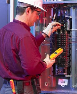

Respect test equipment
Using appropriate test equipment for the circuits being tested, and being familiar with the equipment, is critical. Many multimeters have been destroyed by inappropriate use, such as having the meter set on the wrong settings. An arc flash and subsequent injury can also occur from meter misuse.
According to an OSHA Letter of Interpretation dated June 22, 1998, you must ask the following questions to determine if rubber insulating gloves are needed when testing energized circuits:
  • Are the probes designed so that the technician’s hand can slip off the end of the insulated handle?
  • Are there other exposed, energized parts that the worker’s hand might contact during testing?
Figure 2
If probe designs don’t prohibit a hand from slipping off the end or there are other energized parts that might be contacted, OSHA says rubber insulating gloves are required.
If you answer yes to either question, OSHA says rubber insulating gloves or other electrical protective equipment is required (Figure 2).
